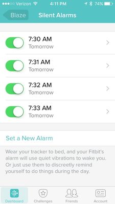

Well I don't want it every single day so I thought that as long as the slider is turned to green and it says it is set to tomorrow it would go off.  So my ap screen look like this:
But you are right, it doesn't make sense that it would be green if the alarm is not set to repeat. Hmmm.  I am going to have to play around with this.  What I am looking for is to be able to set this series of alarms just on the days I need it.  So I thought as long as they were toggled on they would go off.   I'm going to turn them off, sync my phone, then turn them on again and see if that works tomorrow.  THanks for the idea!
@Heidstirr  so you were right on track with your question.  even though the ap indicates the alarm is on for tomorrow (i.e. the slider is green and says "tomorrow" like in my photo above , and the watch shows on for tomorrow ...i.e. bell is green ), it really isn't on. once I have used the alarm, to make the alarms work again, I have to turn them off on the phone, sync the watch, then turn them back to green and sync the phone again.
i see in the ap where I can chose it to repeat on particular days but I don't want to do that.
i think that once the alarm is used, if it is not set to repeat it should show "off" instead of "on" in both the ap and the watch.  that would make the most sense.
