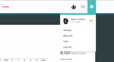

Got my Blaze on Monday charged it over night and been wearing since Tuesday. Like it so far however....
Today (Thursday) it went from medium charge as seen in this image to dead. With no warning. I just wanted to know the time, went to look and saw the red flashing battery. It synced about an hour and a half ago and the battery was as in the photo....
Do I have a problem? Is there a fix? Or do I need to return this...
Mine is similar. It goes from what appears to be medium to flashing red in a few hours. Far from the claimed 5 day battery life. In fact, your experience of approx 2.5 days mirrors mine.
