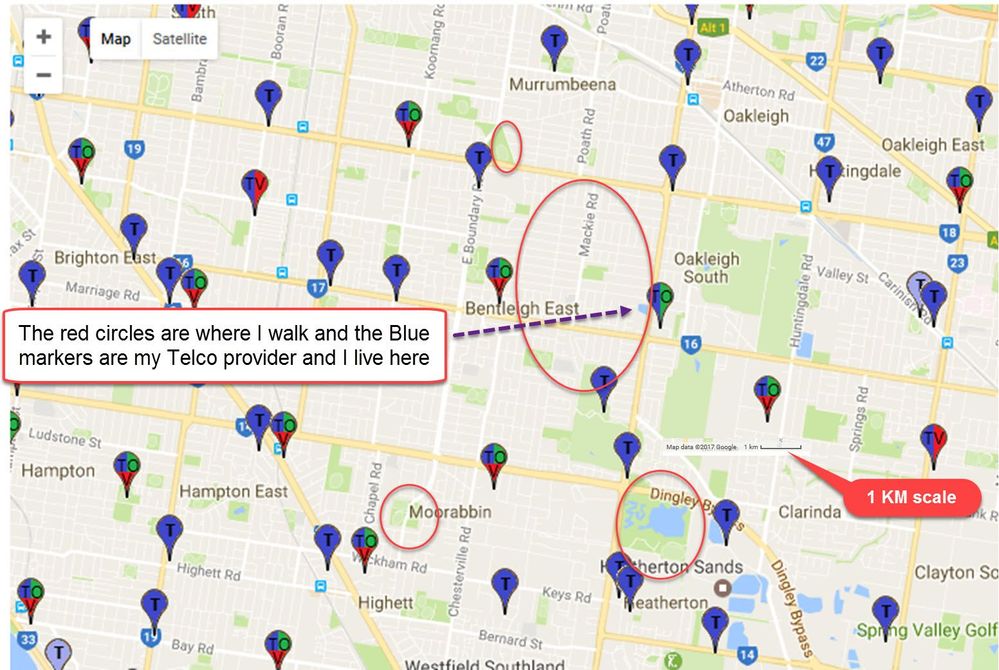

Below is the proximity of my Telco mobile towers and no tall buildings in the way. This maybe the reason why I don't lose signal because I'm not switching between towers to have a continuum pickup of the Connected GPS. My provider has many towers as per the image.
The 1km legend is difficult to see but in every walk area shown I have never lost signal.
Edited and added Next week I have to go down country and the nearest single tower is 7km inland and the sea on the other side. When you consider I'm within a 1+km in the precincts of my home.. We will see what happens. I will have both Surges as well..

GPS does not connect through telephone towers. Once connected you do not need any telephone connection at all. However if the GPS connection drops you will need it to reconnect.

@Julia_GI understood that the mobile towers were used to help triangulate your position and feed back to the Android phone, in turn to the Blaze via Bluetooth.
