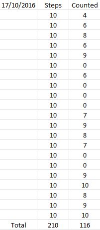

@FerdinandFitbit I've been tracking my steps today, each time I get a reminder to move, or sometimes before I've been trying to hit 250 steps in the hour.
I tried it in batches of 10 steps and recorded what my blaze counted as you can see in the pic.
It varied from 0 to 10 each time and only counted 10 twice, this was all done in about 10 minutes but has been happening all day.
This really isn't acceptable, I read an article recently where FitBit was prmoting itself not as a tech company, but as a health company. If it can't even get the step count right then how could this ever be relied upon?! Surely it's primary reason for existing is to count steps, all the rest is just fluff.

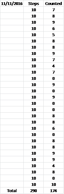

So my Blaze is still incapable of counting steps and, following the complete lack of support from fitbit I decided to do another check today.
I've just phoned support to request a full refund. I'm not going to wear a tracker that can't do it's fundamental job any more!
What did Fitbit do for you when you called?
