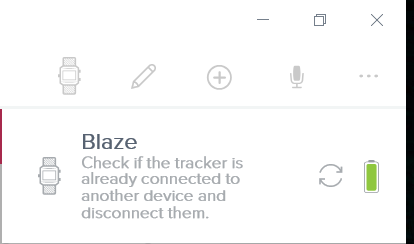

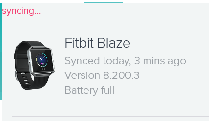

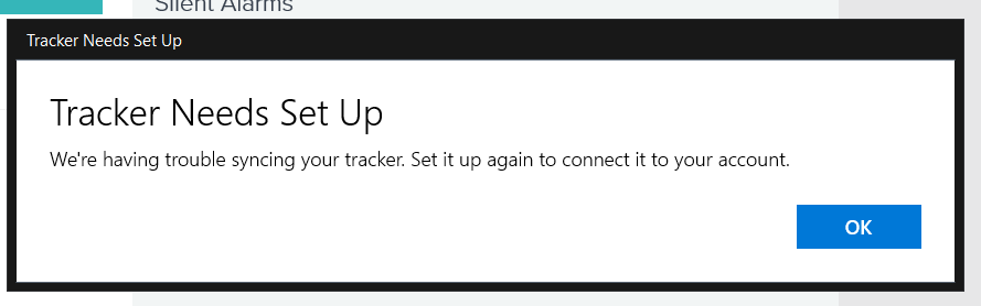

What actually happened to my 3 months Blaze? For more than one week, I could not sync anymore after initial Setup. I have reset the device by pressing the left/right button. I have unpaired and re-paired the device. Removed from account, and re-added. Windows 10 FitBit App could detect the tracker, and after initial setup, it could retrieve the activities data, but after a few minutes, it could not do the automatic sync anymore. Please kindly give suggestion on how to solve this frustating sync problem. [img]http://image.free.in.th/v/2013/iq/160914121801.png[/img] A succesfuly initial setup. It could sync the activities data. [img]http://image.free.in.th/v/2013/ij/160914122415.png[/img] After a few minutes, it failed to make automatic sync. [img]http://image.free.in.th/v/2013/iw/160914122644.png[/img] I have never tried to attach the tracker with other computer/phone, but it said that I need to disconnect with other device.

First image shows successful setup, successful sync after initial setup. Data retrieved correctly.
Second image, after a few minutes, it failed to auto-sync. Need setup.
Last image, it said that I need to disconnect the tracker from other device. I had no attempt to connect the tracker with other device except this Windows 10 notebook.

@SanFit please understand that you will never get the Blaze LE paired to a phone through the Bluetooth Settings screen, you will always get a rejected code message.
I'll try and say it different thN i didin the last post.. it is the job of the app to pair the tracker.
There is no need to disconnect your tracker from your account, you won't be able to do anything until it is reconnected and you will loose any instances data.
Since the app is asking you to set it up again, go to your device menu, click add tracker, when your asked if you want to add or replace choose your Bkaze, then follow the prompts.
