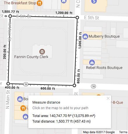

Odometers aren't as accurate as you might think @Dawntx . Try a third reference, go to googlemaps, zoom to your location, left click and select "measure a distance" click a point on the map, then another, and another, etc until you link your route - a summary pops up for the distance when you close the route:
In this example it is a quarter mile around our town square.
If you are still a whole mile off you might contact customer service and let them know what you have uncovered.
