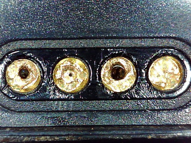

This appears to be a common problem. My blaze stopped charging the other day. When I examined the contacts on the back with a digital microscope it was obvious that the charger pogo pins had worn holes in the contacts, obviously breaking the connection to the internal wire. In my humble opinion this is a design flaw or planned obsolescence. Since my Blaze is well out of the warranty period I did not bother to contact Fitbit. I truly like my Blaze and for what it cost it should have not worn out in this manner. I have an A Watch as well, but it doesn't track heart rate as well as the Fitbit nor does it track sleep without a third part app. So I really want to resurgent  my blaze as I do not like the looks of the new Fitbits and honestly I invested too much in the blaze to just throw it away. So I did order a replacement back cover on a well known Auction site. It was roughly $15 USD.  I figured it was worth a try. I have not received it yet. When it arrives I will install it and post an update.

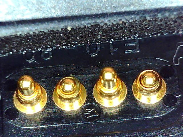

I received the replacement back, but then realized that I didn't have a T3 bit to remove the old back. When that finally arrived it was a fairly easy swap. There is a video on YouTube that I recommend you watch before attempting it. The toughest part was removing the sensors from the old back without damaging them. With my old eyes I had to use a digital microscope to remove the heat stakes that hold it in. But for most a magnifying glass should do. Then you will need a soldering iron with a fine tip to melt the posts that hold it into the new back. Having said all that, it tool 15 minutes to repair my blaze and it is working fine. Total cost of replacement back and T3 screwdriver, roughly $20. I've attaches a couple of photos of the contacts pre-swap
