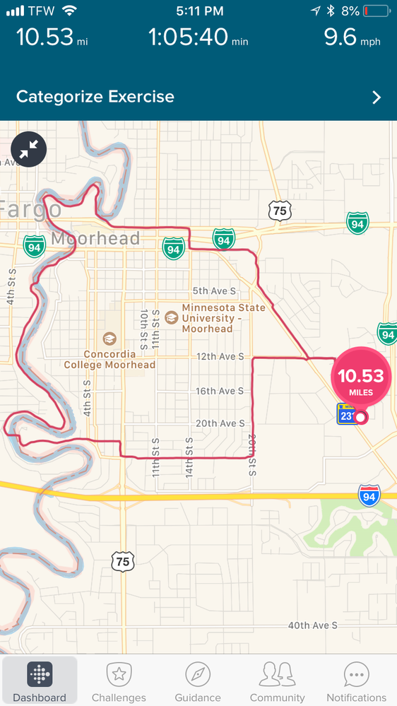

Same issue. I bike the same short route every day that I’ve been able to for the past few weeks. The distance should be about 10.5 miles. It tends to underreport the distance if I go faster, I’ve noticed. There are no GPS gaps in my maps, and the only deviation would be by maybe 20 feet. 766A5E7E-625E-4DD2-A990-605CB5069F82.png
 So why are the maps above near half a mile in difference?
