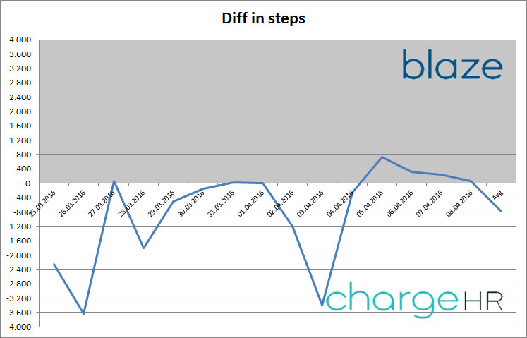

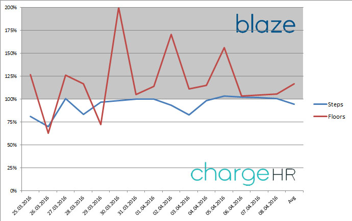

My Blaze counted way too few steps as well. When walking lightly I could see that the counter didn´t count any steps for long periods of time. I decided to do a comparison with my old charge hr and created an account on my wife’s phone. The first few days the results proved my right. The Blaze was way behind the charge hr.
But somehow, after a few days, the Blaze started to reduce the difference and now, after 15 days they’re close to identical. This weeks workweek hustle had the Blaze at 80562 and the Charge HR at 79266, a difference of a 1084 steps. Checking out the total period of 15 days leaves the HR at 212k and the Blaze at 200k steps.
I’ve tracked everything in excel and here you see the charts. 10 of the 15 days the steps are within 5% difference. The other five days the difference is above 1000 steps difference with the worst at 3641 steps difference. Of the 5 days, 3 of them are within the first 4 days.
Steps:
I’ve also counted floors and I find it way more unstable, but I don’t really care.
Difference Steps / Floors: (in percent - the closer to the middle of the chart the better)
Difference in steps:
So, tonight, after 15 days I put my charge HR in the drawer and walk of with the blaze (and cross my fingers for a firmare (clock face, log water, removing heading on today) update soon.
