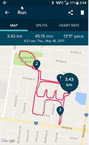

Here is an example of my 45 minute walk this morning, no dropouts and accurate
