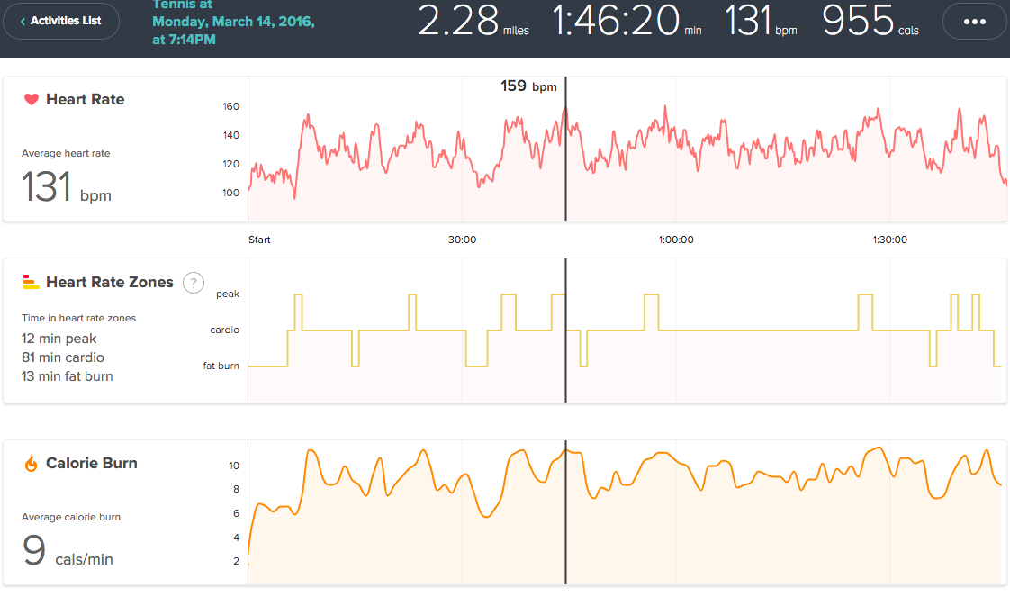

Follow up to my previous posts.  I returned my Blaze and picked up a replacement. Tonight I was able to check to see if the heart rate tracking was working better with the new one.  It appears that it is better.  I believe the tracking is correct (screen shot below...compare to previous post above.)
My conclusion is that I had a faulty model.  Fingers crossed that I don't experience any more issues.
