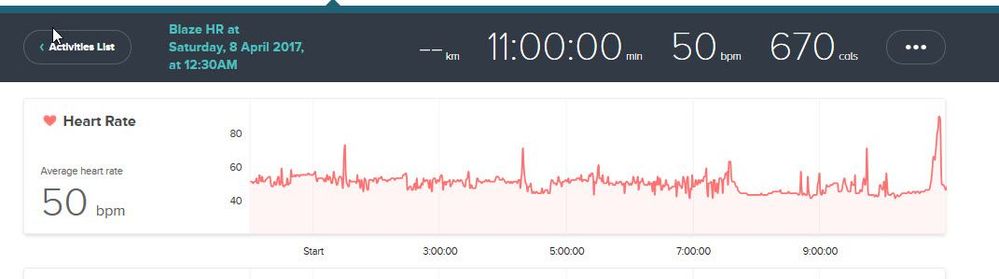

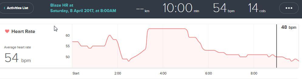

The images here are an 11 hour period last night.spikes are bathroom breaks. I have also "homed" in on a 10 minute period. When doing this you only get a plot every 10 seconds. A few months ago it was every 2.5 seconds.
Colin:Victoria, Australia

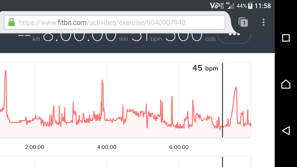

The graphs didn't help me because I have a genetically low HR and I found that Fitbit varied on the pulse data being used.. In this link from last year you can see what the issue is..
The 3 larger spikes are my bathroom breaks..and the other restlessness was me going to bed after moving many things for our painter renovator. Too close to bed time.. I still had nearly 8 hours sleep (by Fitbit) because I went to bed before 11pmSmiley Happy
Today for 2 minute periods I received 11 plot points for around 2am and 21 plot points for for 1-45pm.  The lowest while sleeping last night was 45bpm.
Fitbit haven't answered whether they average or only record a beat when it changes..
Maybe @LanuzaFitbit who has replied in the link I have included can help us...

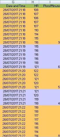

@ceholliI have just downloaded my data from an external source and it averages 6.3 plot points/minute for 17 hours today.. Typically 3-7 plot points while sleeping and 7-11 while awake.
The same thing a few days ago when I achieved 45 minutes of Active minutes, high calorie burn etc.  The same, 9050 plot points for 1440 minutes..Ave 6.3 again..  My RHR was 52 on the day of the data below.. So it peaked at over twice my RHR.. My maxHR is 143 for my age.
In any comment I make, I accept that the Fitbit hasn't the accuracy of a medical device and there are many Fitbitters who have taken appropriate action when they felt the results made them feel uneasy. A trip to their GP and in turn experts helped them through the issue.
When I examine the data it appears that must be some rationalizing because in the table below the plot points from external are exactly the same as my Fitbit Custom graph.  From these you can see its useless for my missing heart beats. Cardiologist passed me on all counts.
So all we need is for Fitbit to explain how the pulses are stored/rationalized.

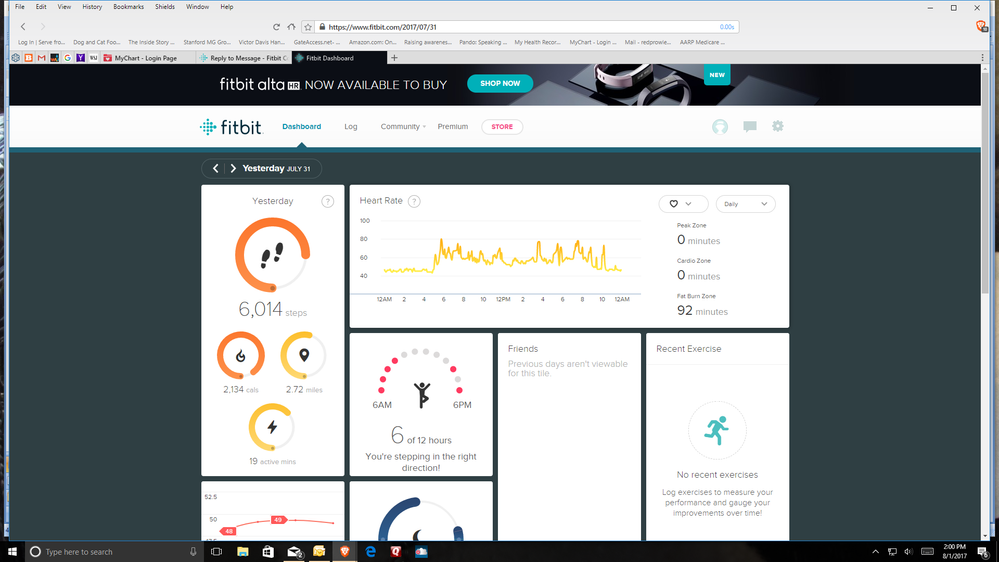

Attached is a screenshot from this morning; showing my sleep and then waking and walking my dog. The graph shows my heart rate, but I would like more detail in the graph if possible. I really need to know what my lowest heart rate is during the night and at what time(s).
Thanks for your support!
ceholli
Sent from Mail for Windows 10
@ceholliThe Custom graph allows you to see the HR but you have to judge the time, or, when you have established where the lowest HR is you create a smaller time period Custom Activity and home in on the area for a more accurate time estimate.
The screen shots show the coarser phone RHR view and the PC Dashboard Custom graph.  to establish the low HR period.

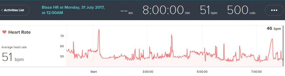

Colin: This is another screenshot; you can see the heart rate for my sleep time is in the low 40's, but I can't get actual numbers, only approximate.  I guess for my needs this will probably work as I am looking for trends, but would like more detail if possible.  My Dr. had me wear a heart monitor last week and will likely repeat the test again next week after I have a stress test.  Until a few months ago my resting heart rate was around 60 now it has dropped into the low 40's.  He is trying to determine why my heart has suddenly slowed down and is hinting that I may need a pacemaker.  The use of the Fitbit is for my own awareness and tracking, I will leave the real tracking to the Dr.  It is comforting for me to be able to monitor my heart rate as the Dr. emphasized  very strongly to me that if my heart rate dropped again and stayed in the low 40's that I was to call 911 immediately.  Ceholli, California
@ceholli Thanks for the screenshot. You can only get the detail from the RHR tile on a phone or create the Custom Activity on the PC Dashboard. Do you need help with that?
