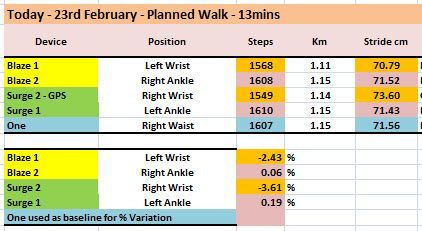

I have a p[air of Blazes and Surges with my One so myu comparisons are fairly accurate.. I also found that walking at exercise speed and definire arm movem,ent, not exagerated I was noremally within 5% on the Fitbit One.
On one test I did below was fairly accurate and I was testing every p[lace we could use a Fitbit,  All of my Fitbits are set to non-dominant because I'm ambidextrous
