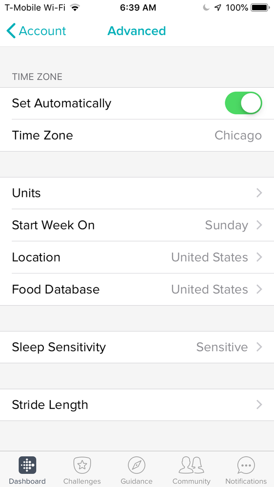

I just called fitbit to troubleshoot. Some of it was common sense troubleshooting. We turned off the heart rate monitor, synced, turned back on, synced. Going to see if that works.
She also mentioned that my heart rate has been up in the middle of the night, causing the device to think I’m awake. I’m late in pregnancy, so it makes sense for my heart rate to be up. We will see what happens tonight.

I forgot - She also changed the Sleep Sensitivity from Normal to Sensitive. It worked! Fitbit reported that I got a full night of sleep last night! We will see if it keeps it up over the next week.

I'll try changing the sensitivity. It's done twice in the last week.
