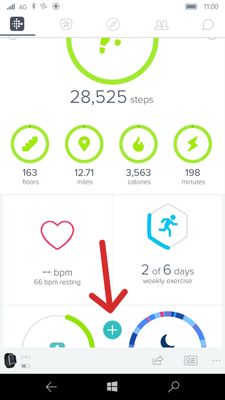

The suggestion about the vibrations resulting in the Fitbit device not recognising sleep sounds reasonable to me, but I think I might have a workaround for you:
The movement and heart rate will still be recorded, so if you add the sleep manually then the data recorded by your Fitbit will be applied, and maybe this will generate a sleep pattern as the processing is done server-side anyway.
Give it a try and let us know the results ![]()
You can log your sleep manually at https://www.fitbit.com/sleep, or in the app's [Sleep] page by tapping [+]
Hope this helps!
Matt
