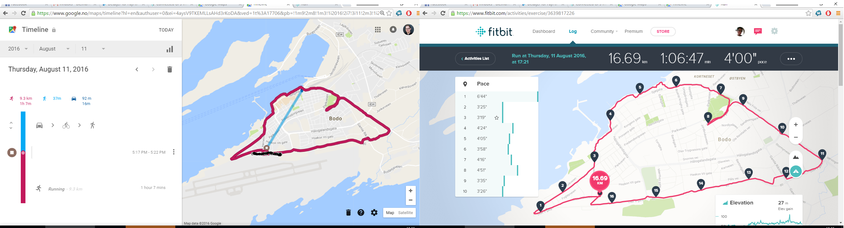

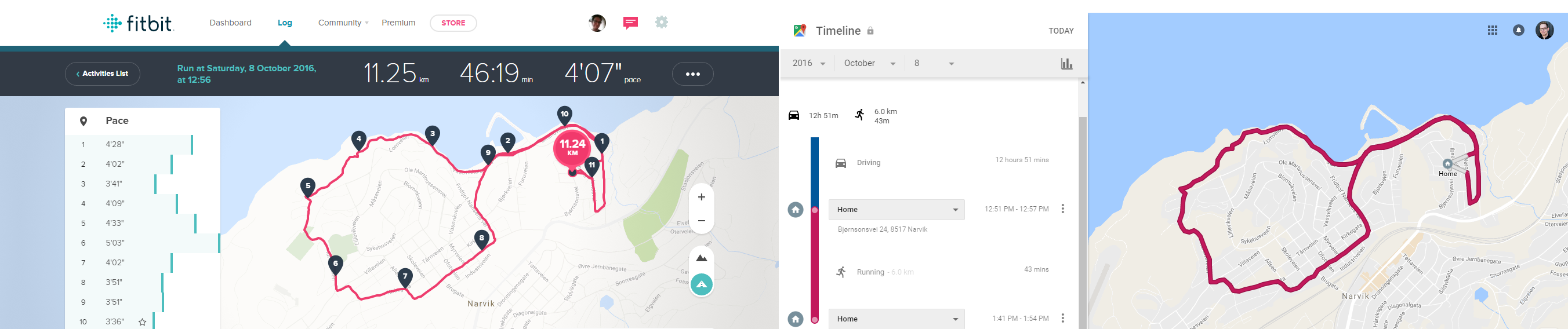

Here are my experience. logged alot. Ive compared many runs with Google map log, and fitbit log. Odd part is Fitbit use actuely mapping from Google.
Its off by several km every single jogging tour ive had
