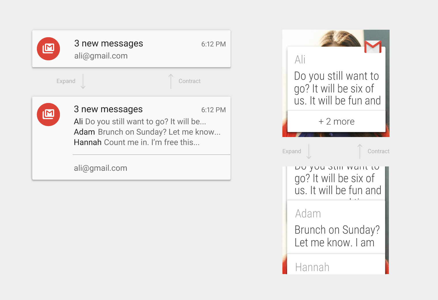

@Rich_Laue Like you I don't have much free time, however on my day job I work with a lot of companies that need our help fixing Android and Linux issues. For example say a customer's engineering team is using Android inside a bar code reader, and can't get Bluetooth module working, thats where we come in and fix it. Anyways, I've got an Android tablet to play around with so I'm familiar with app development, but otherwise don't use the platform.
While looking up a technical detail today, I came across this:
Source: https://material.google.com/patterns/notifications.html#notifications-content
Handset on left, wearable on right. You can see that its Google's intent that you can expand the summary, on both handsets and wearables.
So "the way Android works" (or suppose to work) is that the wearable can expand summaries and see individual messages.
