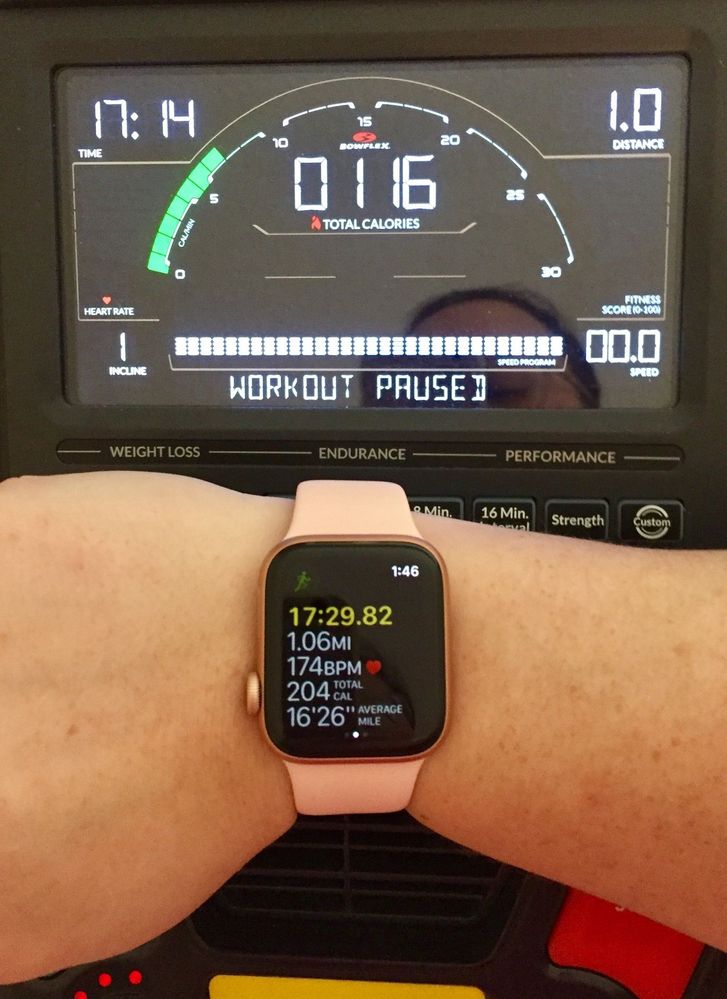

I’ll be doing my first virtual race (a 1 mile run) in a few days and I have no idea which is the most accurate time/distance for submitting to the race results. 23447B6F-7614-4841-A55F-698125EB521A.jpeg

Fixed the distance accuracy issue - bought an Apple Watch.Fixed the distance accuracy issue - bought an Apple Watch.Fixed the distance accuracy issue - bought an Apple Watch.
@SunsetRunnerit is still off by a tenth of a mile, that is because the AW is not able to measure the distance while you are walking/Running in place. It, like Fitbit needs to calculate, think of it as taking an educated guess. The better the user sets it up the more accurate the guess will be  Did you set both devices with the same stride setting?
You can't trust Fitbit to get your stride from gender, and height, at best the stride setting will simply be another guess.
