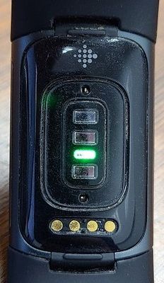

About two weeks ago my battery started to drain rapidly, lasting maybe 12 hours on a full charge. What I've noticed and hypothesize may be the root cause, is the green LED on the back is on 100% of the time including charging and resets. The only time it goes off is when the battery depletes 100%.
