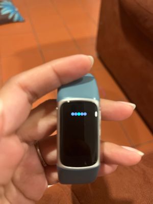

My charge 5 is only 4 months old. As of yesterday, it’s stuck on a black screen with 5 green dots on top. Similar to the screen for instructions for EDA. When I plug into charge it works. I have fully charged it yesterday. Please advice.

Hello @Shafiya and @Mmachad
Have you tried restarting your Charge 5?
You can do a harder restart by connecting it to the charging cable then pressing the button at the USB end 3 times (you might have to experiment with the timing between presses).
Hopefully the Fitbit logo should come up and it should restart.
 I really hope that works for you both!
I did the reset. It’s working as normal for now. Will keep you updated.
Try the reset method suggested below.
That’s great news @Shafiya !

Shafiya - I just tried for a million times again and I remembered in the hundreds of comments that somebody suggested to change the clock face. I deleted the device and reinstalled on my phone. And I don't know how and why but it came up. I changed the clock face and now I am waiting. Hopefully that'll work.

That seems to be strange to get it so close together.  I think it would be a good idea to contact Support for help.  You can do that by tapping Help at the bottom of the page, then Get Support, then Live Chat (you can attach your picture then).
As @BaerbelB says, sometimes changing the clock face can help, but the dots happening again so soon sounds more serious, so asking Support would be a really good idea.
