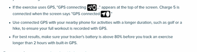

Have you checked your exercise session on the App? You need to sync and then the map should show up. Sometimes there's a bit of a delay though...
Did you see the GPS connecting during your walk? A little icon should show up when you start and once it's connected, you should officially Start your exercise. It disconnects or won't work properly if you cover it with your sleeve or go under thick trees, that can be an issue too.
Other things to try are restarting your Charge 5 by swiping down from the Clock Face to Settings, tapping, then scrolling up to Restart Device.
I'm really sorry it didn't work this time but it should. I don't know if it makes any difference at all, but mine is set to Dynamic. I don't take my phone with me so it ends up using the built in one anyway.
