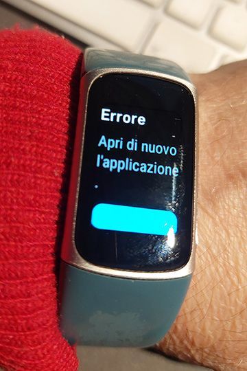

Today the 'ECG shows an error screen, saying to restart the app. I restart but it's the same.
I restarted both the Charge 5 and the smartphone, but if I try to do the EGG the screen appears:
Restarted again Charge5 (Settings > Restart), restarted also the smartphone...
Now I returned in the same situation as in the first message: Charge5 turns off after starting the ECG.
