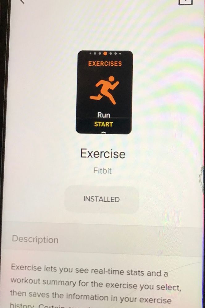

My new CH5 started draining itself so I turned off the watch activity shortcuts (run,bike…..) via the app. See my previous posts for instructions to turn shortcuts off.
Go to your account on the app.
Go to your device
Go to Gallery
Tap on the Apps tab on the top of the screen
Tap on Run, Bike etc. You can’t delete Exercise. I can’t remember tapping either the Exercise or individual app for bike , run, swim and slide left and the delete button shows up.
Tap delete and the shortcut goes away.

Thanks.
I tried following your instructions but when I tap on apps, then exercise, I get an icon for “run” but nothing happens when I tap on it - see photo below
I went to the website and tried to delete all exercise shortcuts but it won’t let me . I ended up unchecking all but one.
This morning I tried pressing the charge cord x3 again and I now have the clock face and also shows battery charging when attached to charger. …

Please see my previous post on deleting exercise shortcuts. That’s what was continuously draining my battery.

I went into the app and tried to remove all my tracking shortcuts (run, bike, swim, etc.), it won’t let me delete all of them. I had no option but to leave one
