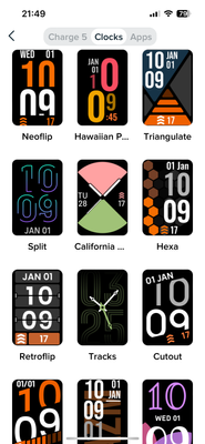

Have any of you who downloaded the updated firmware get any new watch faces? I did not get the new faces with the firmware download and there were supposed to be 5 new ones. Anyone?

I'm new to Fitbit. Just got my Charge 5 updated last week and saw these Clocks watch faces.

@hoangen these are all the old faces. There were supposed to be 5 additional new ones. Big fail on the part of Fitbit as usual...
