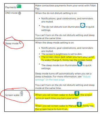

Common issue, likely simple fix.  Swipe down from clock screen to get to Quick Settings.  Probably accidentally either have Screen Wake set to Manual or are in Sleep Mode.
4 REPLIES 4
   Thanks.  That was the problem.  All fixed now.
