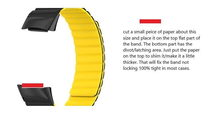

Yup, that worked great, didnt do it too precisely to test it but ripped a bit of paper off, insert it to the flat end on the bottom clasp, insert strap, same click but now there is less play and you cant pull or twist it to pop it off. Manufacturing defect for sure then on the bottom clasp clearance tolerances.
Paper will get wet so find some thin mylar or thin cutout of a plastic bottle for the perm fix. OR even a dap of hot glue and push in, that would give the extra "shim" and lock it in place.
But this works to fix it till manufacture admits it is a defect/recall issue.

The band has a flat side and a side with the small divot that the Fitbit locks onto. The issue of the band popping off is the Fitbit cavity the strap inserts into is too high by about a price of paper thickness on some of them. I didn't cut an exact size as he did but I just ripped a small price of paper to just the size of the flat section of the band that inserts into the Fitbit. Then carefully push the band in with paper in place and click. It well now be incredibly hard to yank off unless you release the clip a you would changing the bands. I can take a photo of where to put it but my Fitbit went back for RMA. Maybe they will have a Charge 5 with the proper manufacturing specs and not pull loose easily. If not. Use paper or thin plastic water bottle or maybe pop can sliver to keep it waterproof
Yeah but the issue is in the manufacturing tolerances on the fitbit. I can swap the "tight top band" in the bottom and it will click but pull out easily. Put either top/bottom band in the top slot and they never come off and I an pulling on them hard. The faulty slot just unlatches easily with a tug or a slight twist.
Wait for device to come back from RMA and have a magnetic band ready for it. But I'll keep doing the RMA game to they acknowledge they have a recall defect issue and to stand by it

Dont have my band to show it or the device back yet but just put a small sliver of paper on the flat section, then carefully insert the band and click in place. You can then tug on it, twist it and it will be secure if that was the original issue.

The replacement Charge5 I got doesn't have this issue using the same band so I know the first one had a defective build. IT was not the latch that was faulty since that latches on 100% with the sliver of paper or vinyl I used in the example above. Just the build tolerance for the gap was slightly too big. But the new one holds 100% and you can pull hard and twist and it wont pop out. Adding the sliver of paper fixed the old defective one as well and held up to the same abuse. So if you can pull on it and it comes off, fix it like above before you lose it or try to get an RMA.
