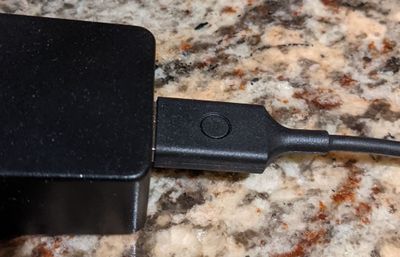

SPECIAL NOTE: I don't know where this button on the charger is that
everybody talks about.. My charger cable doesn't have a button. It's the
USB cable that came with the Charge 5.
Yeah, I never knew about that button until someone mentioned it here.
Bottom of the charger there is a little circle button. Look it’s def
there
