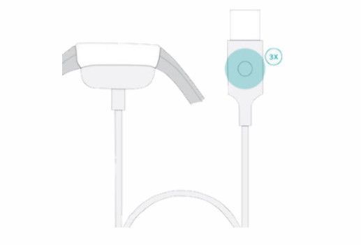

Are these instructions correct for the Charge 5? My charger doesn't have a button anywhere on it - only the two pins that connect to my tracker.
Look at the other end of your charging cable, the bit that connects into the charging plug!
Hi & welcome @Jenkat979
There is a small inset button on the USB end of the charging cable that came with your Charge 5. See picture below:

Hello & welcome @rvloh
This is the button that you press 3 times.
