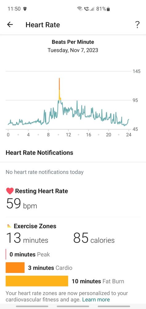

I bought a Charge 5 recently. Being 70 years old my only exercise is walking the dog, the Charge is to keep track of steps and heart rate. Where I walk the dog there's a few hundred yards of flat track then a steep hill. Along the flat my heart rate rises - according to the Charge 5 - to around 85bpm, just after starting up the hill there's a sudden spike to around 138bpm, then it drops back down to around 107bpm. This spike doesn't happen every time. Anyone experience the same or have an answer?

I can make my Charge 5 spike on demand. All I have to do is roll my wrist as if I were conducting an orchestra. Seated I recorded 135 bpm when at the same time I had two fingers on my carotid counting the real score of 65 bpm.
Hi and thanks for your reply, I suspected as much so it's great to hear someone confirm my thinking. I can put it to bed now knowing it's an error.
