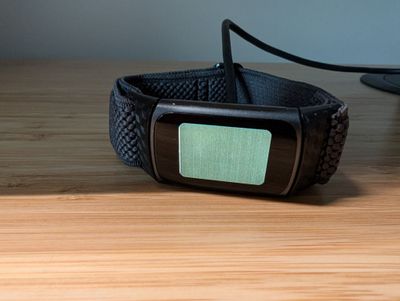

I have a 2 year old Fitbit Charge 5, which has suddenly developed an issue with both the battery and display. Over the weekend, I noticed that the battery had depleted after just 3 days, where it would normally last all week. After charging it for a few hours, the display has been showing this permanent static glowing pattern (see attached photo below).
When the Fitbit is attached to the charging cable, my phone can sync with it. But as soon as it is detached from external power, no connection is possible and the screen remains black. I have reset the device, but this has not resolved the issues.
I suspect that the battery has failed. Can anyone confirm this or offer any other troubleshooting steps that I can try?
I have attached photos showing what the display looks like when charging.

- Initiating a reset does seem to restart the device as it vibrates 5 - 10 seconds after pressing the button three times. However the screen remains the same.
- Changing the clock face from "Target" to "Continuum". The device vibrates after the clock face installs successfully, but the display is black.
Since posting earlier today, the display is now black instead of showing the corrupted pattern. A single white line flickers when connected to power, but the screen stays black even when restarted.
