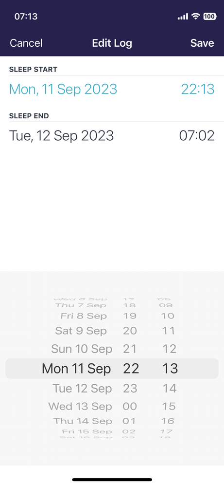

@PayitFwd OK, that is 33 hours and 1 minute. I can only guess that this log is overlapping another sleep log, which would be why you are getting the message.
Assuming you actually went to bed a 9:13pm on Sep 11 and slept for 9 hours and 1 minute, then you need to edit SLEEP END to 6:14 on Sep 12, not Sep 13 - simply drag the date one day back. OTOH, if you actually went to bed a 9:14 on Sep 12, then edit SLEEP START from Sep 11 to Sep 12; again 9 hours and 1 minute - in this case, drag the date one day forward.
Here is a pic of my sleep edit screen: my SLEEP START is Mon 11 Sep at 22:13 and I was in bed for 8 hours and 49 minutes, until 07:02 on Sep 12. If I wanted to get the START to Sep 12, I would slide the date up one day (note, app wouldn't actually let me do this since then - for this sleep log - my SLEEP START would be after my SLEEP END...). If I wanted to change the SLEEP END date, I would first tap on the SLEEP END data (and it would turn blue) and then slide the day (but if, for example, I tried to change it to Sep 13, it would result in a sleep time of ~ 31 hours, it wouldn't actually allow me to do that, given that I already have a sleep log for the night starting Sep 12, and I would get the same message you did...).
