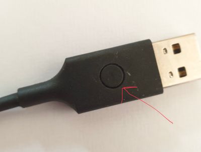

Hi, @rhhanson the advice you quoted is to give your Charge 5 a restart. This is a very useful first troubleshooting step and can solve many issues.
If you are using the charging cable supplied with your Charge 5 there will be a button on the cable, but it is a little hard to spot at first. Hopefully this picture will help you find it:
You should definitely try the restart procedure - and if it doesn’t work the first time please try again as it can be a little tricky to get the rhythm of press - pause - press - pause - press just right (I find if I say the words out loud as I do it helps)

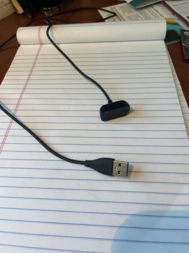

Thanks for your reply. Good news, bad news. Good news first. Two days after the Fitbit App icon appeared on my Charge 5 screen, it disappeared and the screen was blank. I hooked it up to the charger, and everything appears to be back to normal. Hope it stays that way. Bad news that doesn't matter as much now, but I truly don't have a button on the flat end of my charger, not on either side. Why would that be?

Hi, @rhhanson the worse news is if that is the charger that came with your Fitbit you may have a counterfeit device. The cable you have photographed is definitely not the same as the charger supplied with the Charge 5 (it has a longer wire, and the real one does have a button and does not have that usb logo/stamp. Where did you buy your Charge 5 from? (If that is a replacement charger bought from a 3rd party seller, then those do not usually have the button, but do be careful as I have heard stories of 3rd party chargers being unsafe and also frying Fitbits.)
If you did not buy your Fitbit from an authorised seller you will not be covered with any warranty.

@rhhanson just a head’s up that without the correct charger, if your screen goes blank or your Fitbit otherwise unresponsive you will not be able to restart. You need the button for the restart.

I just ordered a Charge 5 charger from Fitbit. I think when I got my Charge 5, I accidentally kept my Charge 4 charger and threw away my Charge 5 charger. I wasn't perceptive enough to notice the difference.

Hi, @rhhanson prob a good idea in case you need a restart again at some point. But this one is definitely not an old Charge 4 charger - the two are completely different and one won’t charge the other.
