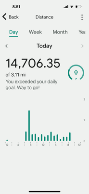

07-30-2024 12:40 - edited 07-30-2024 12:41
Fitbit made me think I was Superman when my charge 5 said I went over 14000 miles in a day. It continues to post outlandish distances. Problem started after last update. Loyal Fitbit user for 8 years PAYING for premium service and now getting chop liver. Thank you Google
