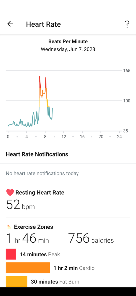

If you set the waterlock before going in the pool and rely on the auto-recognize feature to record your swim you will get HR. This is my swim this morning.
All you need to do is set the water lock, and your "Charge 5" will recognise you are swimming after 15 minutes (you can adjust this time) You do not need to "Finish" the swim exercise, just go home & sync the app on your phone.
