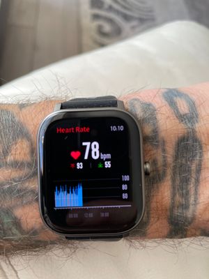

Well just to let a lot of people know I have now got and believe it or not an Amazfit GTS and it is perfect all the features works great even the heart bpm and ecg all running perfect and £50 less than the Fitbit charge 5 I’m over the moon what an impressive watch the amazfit is, I sent my Fitbit charge 5 back got a refund and bought the amazfit gts for £69.99 that’s after a £20 voucher deduction which all customers get but in reality Fitbit should definitely warn consumers that this watch will not work over any form of tattoos because lack of LED lights on the rear hope this helps future buyers
Will definitely not work over tattoos it hasn’t got enough led lights now I have a amazfit gts which works great over tattoos as it has more led lights on the rear and the app Zepp is better than the Fitbit app
Just to let you I’ve got the amazfit gts and it works fantastic over tattoos thanks to you I would have drowned myself in sorrow if you hadn’t posted your review the app Zepp works better than the Fitbit app and syncs ultra fast well pleased all round watch with super amoled screen big watch face 1.65 well chuffed
