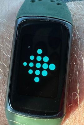

I’m having similar issues. Originally got :cross_mark: on the screen. Tried charging and the :cross_mark: changed to the Fitbit logo  In both instances the unit was unresponsive. Put it on the charger for a full day and it came back to life, synced, all good. Then 2 days later totally unresponsive. Tried resetting several times but nothing. I see lots of people with the same problem or similar, but have yet to see a response from Fitbit techs.

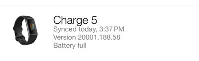

  3. Please sync your device in the Fitbit app by tapping your profile picture > Charge 5 > Sync Now.
  4. If you  can't sync, tap on your profile picture > Charge 5 > Tap to see if a firmware banner appears.

Did all of that and have been since this all happened over last weekend.. This is all we have.. Sometimes when it goes from full battery it will work for 10min to a few hours.. The goes to the logo until it drains the battery in a couple of hours to 15% then there is a new battery low screen as it works until it crashes again draining the battery completely

This is similar to mine as of this morning, but mine isn't actually dead - the screen just won't turn on. It is still counting steps, tracking my heartbeat, syncing, everything like that. But the screen is completely black. I hard reset it twice from the charger end. Both times, it returned to normal for about five minutes, then the screen stopped working again. The app keeps asking me to update the firmware, but it never completes and it continues to ask me to do the same. I assume I'll have to call customer support, but wanted to give these details since I initially thought the thing was completely dead, but it isn't. Gives me hope that if they fix what I assume is a firmware bug, that this might still be salvageable.
