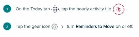

@ElderlyFitLady I'd suggest to first check if the reminder to move is actually set to "On".
To do so, please open the Fitbit app, then follow these steps:
