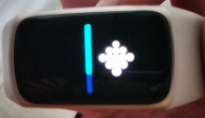

It's not this screen by any chance?
A couple of months ago my screen just stopped working. At first I thought it wasn't charging.
Contacted fitbit support, they are really good at troubleshooting. Cleaned the charging portals, did the reset... Pushing the button in the flat end of the charger 3 times consecutively when it's on charge... The FitBit App was showing the device charged. So it is charging the screen will just not show clock face or stats.
Troubleshooting asked me to change the clock face. I did that. And again get the screen above.

Hi, @Lisa_T_NI the screen photo you posted is a download in progress, your Charge 5 needs to be on charge and close to your mobile phone with the Fitbit app running. How do I update my Fitbit device? - Fitbit Help Center provides guidance & advice.
