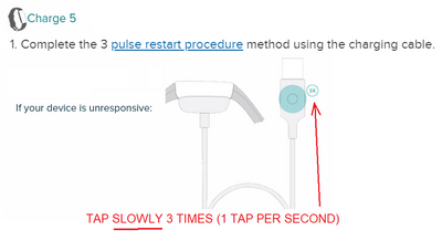

Hi there, @Nanafit54. Welcome to the Fitbit Community Forums. Thanks for the details provided in your post about the issue with your Charge 5.
There are some general recommendations that are usually helpful with any type of display issues. If you haven't done so already, please try the steps listed here below that have been useful for other users:
  1. Complete the 3 pulse restart procedure method using the charging cable.
  2. Please sync your device in the Fitbit app by tapping your profile picture > Charge 5 > Sync Now.
  3. If you  can't sync, please try tapping on your profile picture > Charge 5 > Tile to see if the firmware banner appears (since a new firmware version has been released for the Charge 5).
  4. If it's still unresponsive, please try changing the clock face as well and check if you're able to see anything on the display.

UPDATE: TAP SLOWLY!  The pulse restart procedure did eventually work for me.
