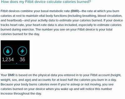

As for calorie burn, Fitbit includes your BMR (basal metabolic rate) calories. These are the calories you are always burning just to stay alive. They usually account for more than half of daily calorie burn. They are credited even when not wearing the tracker, and if just started wearing it today, all day's BMR calorie burn so far would be included in your daily calorie burn. To see what Fitbit uses for your BMR, you can look back at history before started wearing and probably see the same calorie burn every day - that is your BMR.
