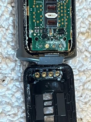

I had the same problem. Wouldn’t charge, and the USB button wouldn’t reset the watch. Customer support was very nice and replaced the watch body. So, i decided to pry the back off the unit. By the way, use a screwdriver in the slots for attaching the band. The picture speaks for itself.

Bye the way, the picture shown in my initial post is of the internal connectors of my old watch. This is inside the watch and you have to pry the back off to see what the picture shows. It looks a lot like the outside, but it isn’t. What we see is a lot of corrosion due to water or sweat getting inside the watch, especially on the left-most connector. Again, this is inside the watch. Nothing you or I can do about it.
