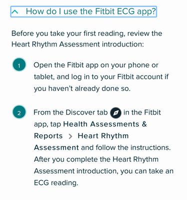

Have you tried going into the Discover screen in the App on your phone to set it up first?  That might be what your tracker is waiting for.
Here’s a screenshot of the instructions.
 I hope it helps a bit.
