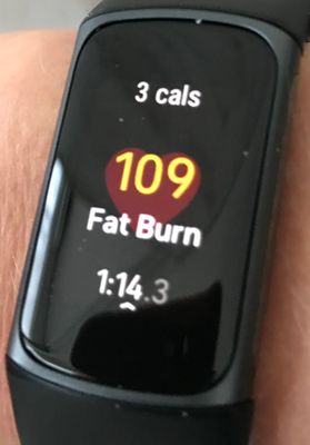

My issue is that I want to see ONLY my heart rate and duration while I am walking, working out, on a treadmill or, you get the picture. This is not the case choosing any of the exercise options. Heart Rate will show up till I get to a heart zone and then it doesn't come back. I do not need to know my steps while walking, it is not like I will say, "Oh wow, look how many steps I have taken!" Same goes with calories, fat burn, etc.
I want to see how much time I have been doing the exercise and my heart rate. I can tell by my heart rate if I need to push more or chill a bit.

You have to swipe up from the bottom on the exercises to turn off Heart Rate Notifications on the exercises so you can see the numbers without interference from the zones, but you do still see Zone information with the heart rate during exercise. That might be what you’re seeing.
I have Always On when I do weight training and I've noticed it shows both the BPM and which Zone I'm in at the same time.
I just tried a quick simulation with a Workout and took a picture.
The number in the middle of the screen over the heart is the BPM and the little arrow at the bottom helps you to cycle through the various stats so if the heart rate goes away, you can get it back.
I hope that helps!

Well, maybe I am still not totally understanding one thing.
Heart Rate on any exercise goes away usually when my BMP is 104+ and after 2 - 3 minutes. The device then gives me Fat Burn and then Heart Rate doesn't like coming back till I have finished my exercise. So, is the number shown on Fat Burn actually my Heart Rate? I think it is based off of the numbers.

Hello @NotYoubutMe
I hope that helps!
