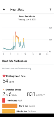

Hi, @SunsetRunner , as pointed out by others HR is disabled for swimming. You may like to experiment by leaving your "Charge 5" to auto-recognize your swim as I did this morning the large peak about 0630 is swimming for 80 minutes.
I hope this helps.
Cheers
