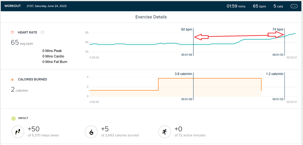

I've just done another test to illustrate... this was sat at my desk. I started a "Workout" exercise on the fitbit and during the first ~60 seconds it was mostly showing "--", but occasionally flashed up a heart rate number, which promptly disappeared again as soon as I flicked my wrist backwards then forwards (or sometimes disappeared by itself before I even moved my wrist), but I didn't note the exact times. BTW - flicking my wrist here just as you'd do when normally checking the time, is nothing compared to how I'd be moving my arms when actually doing a physical workout!
After ~1 minute, I made a mental note of the time, and kept flicking my wrist back and forward to keep turning the display off / on, and which seems to cause it to show "--" continuously.
So for the period for ~1:00 minute through to ~1:53 (see red arrows) I only saw "--" on the display. I didn't see any heart rate numbers flash up. During this period I moved my other arm and legs around a bit to try to make my actual heart rate change, but all done while still sat at the desk. This was just a test to see what would be recorded, not a proper workout.
After 1:53 it then showed a heart rate on the fitbit screen, and I could see the numbers increasing - i.e. it then seemed to be working as expected.
Heart Rate Recorded When Screen Showed "--"Heart Rate Recorded When Screen Showed "--"
But as you can see, in that ~53 second period when it only showed "--" on the display, it does seem to have recorded changes in heart rate. And more over, it's non-linear, so it doesn't look like it's just interpolating to fill in the gaps.
