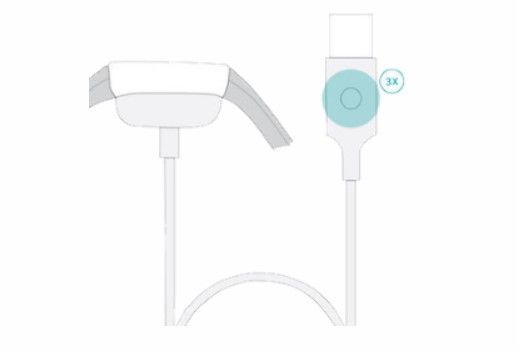

Hello & welcome @HelenBl
Sorry to see that you're having problems with your Charge 5 properly tracking your heartrate.
To restart your Charge 5 using the 3 pulse method, you need to use the charging cable that came with your tracker. There's a small inset button on the USB end of the charging cable. See picture below:
You can also restart your Charge 5 from the Settings menu on your device.
  • Swipe down from the clock face to get to the Settings menu
  • Tap on Settings to open and swipe up until you see RESTART DEVICE
  • Tap on Restart Device, scroll up, and tap on RESTART tile
Hopefully, this will get your tracker back to properly recording your heartrate.
