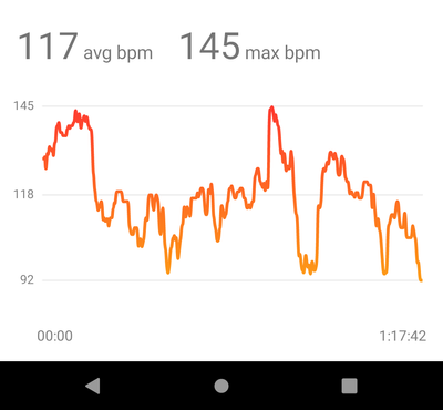

The Charge 5 seems to randomly make drastic miscalculations for heart rate during exercise, and I'm losing all faith that it is able to measure heart rate at any time with any degree of consistency or accuracy.
The drops are usually to about a half or a third of the actual rate.
It will sometimes be accurate within 1-2% for a while, and then just completely drops the ball, and nothing seems to get it reading again, not adjusting straps, not rebooting. And I've been watching it while comparing to an actual on-chest heart monitor, and when the fitbit does pick accuracy back up again, it seems to be without any external changes.. no adjusting position or restarting or anything, it's just suddenly accurate again.

I've been trying so hard to get this to device to work for me and help improve my lifestyle, but I'm really not happy. I'm seeing a lot of people saying that other devices weren't as bad, but this is my first Fitbit device, so I've got nothing to compare it too (well, except for a selection of other heart monitors which all show similar figures to each other, but completely different numbers from the Charge 5).
Some days it seems better than other, perhaps after a fresh charge? I'm not sure whether there's an pattern to these issues or it's just an outright hardware design failure, or bad software implementation, but then it's not my product to investigate, I'm just reporting that it categorically IS a major issue.

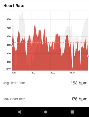

Just did a bike ride. The Polar chest strap averaged my heart rate at 153, where my new Charge 5 stated my maximum was 147. This is just a bizarre difference.
