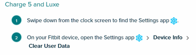

The other option would be
I'm not sure what all that would clear; I suppose nothing about the firmware/OS.
