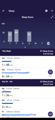

I posted a few replies in other threads, but I'm not sure I've seen anyone else with my exact issue.
Since I got my Charge 5 last week, I've gotten a sleep score on the main/start page of the app most nights, but when I tap the sleep metrics on from there (main page), there's no sleep entry on the actual sleep page (see screenshots).
https://ibb.co/0nxcRHx
https://ibb.co/NWTZqkB
The sleep time itself is logged and I can see it on the web dashboard. Sooo... what the heck?!

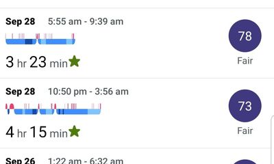

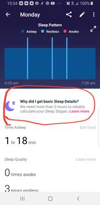

Hi @icantremember why not post your screen shots directly?
Also your second screen shot does show sleep scores. I circled them.
Now tap on the shorter periods and read the message under the graph.

The first screenshot (main page) is from last night (Tues or Weds, I forget how it shows) but it doesn't show on the Sleep page -- the 5 hours 50 mins with score of 57 is nowhere to be seen. Each empty night on the Sleep page should have a score matching what I'd seen on the main page for that day.

I think the majority of users are not receiving Sleep Score and some users also mentioned not receiving regular sleep data at all as well. If you're not getting Sleep Score, keep in mind that you must see sleep stages in order to see a sleep score. There are a few scenarios where you might see your sleep pattern (which shows your time asleep, restless, and awake) instead of sleep stages:
  • If you slept in a position that prevented your device from getting a consistent heart-rate reading or wore it too loosely. For best results, wear your device higher on your wrist (about 2-3 finger widths above your wrist bone). The band should feel secure but not too tight.
  • If you used the Begin Sleep Now option in the Fitbit app (instead of simply wearing your device to bed). For more information on automatic sleep tracking, see How do I track my sleep with my Fitbit device?
  • If you slept for less than 3 hours.

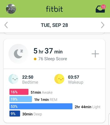

On the sleep page, I see two sleep periods. 5:54 & 1:48
The second sleep has a score while the first does not since it is less than 3 hours
On the dashboard the two sleep periods are combined for a 5:50
Fitbit averages the Sleep Score on the dashboard, so yes it probably will not match the score for any individual sleep.
IE here is one of mine.
I appreciate the help, Community Legend, but the main page with the 5:50 and 57 in my screenshot are not from Sunday, they're from last night. Each night that is not represented on the Sleep page graph actually had a sleep score on the main page the day after I slept. That's my issue.
It seems you're just trying to discount my problem instead of reading my post. It's confusing because the Android fitbit app doesn't put the date on the main page, but the issue is real. I've had various fitbit devices and this is the first one exhibiting this behavior.
