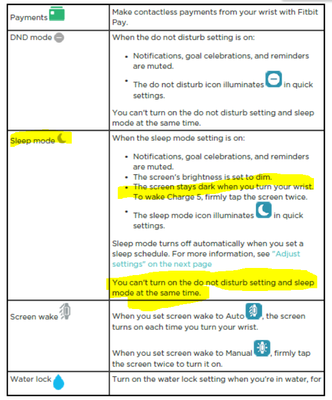

I admit I have not given the 5 a fair shake, I did see how I can wake by selecting auto on screen wake.
However my screen is not very responsive - some options like DND and Wake don't respond when I tap it. I tried light tap, hard tap and reset both on the band and the USB method (3 quick clicks a second apart) however it didnt work, I still cannot select wake, its grayed out
Am I missing a setting somewhere else?
01-05-2022 20:38
01-05-2022 20:38
NVM i figured it out, I had sleep mode on
01-05-2022 20:47 - edited 01-05-2022 20:55
@edavis711 wrote:I admit I have not given the 5 a fair shake, I did see how I can wake by selecting auto on screen wake.
That probably means you are in 'Sleep Mode', in the same 'Quick Settings' section where I expect you saw DND and Screen Wake. "Sleep Mode' is to prevent interruptions when asleep, overriding DVD DND and Screen Wake. Read section below taken from Charge 5 manual (PDF)
I expect these have nothing to do with screen sensitivity.

Yep...Thanks!
